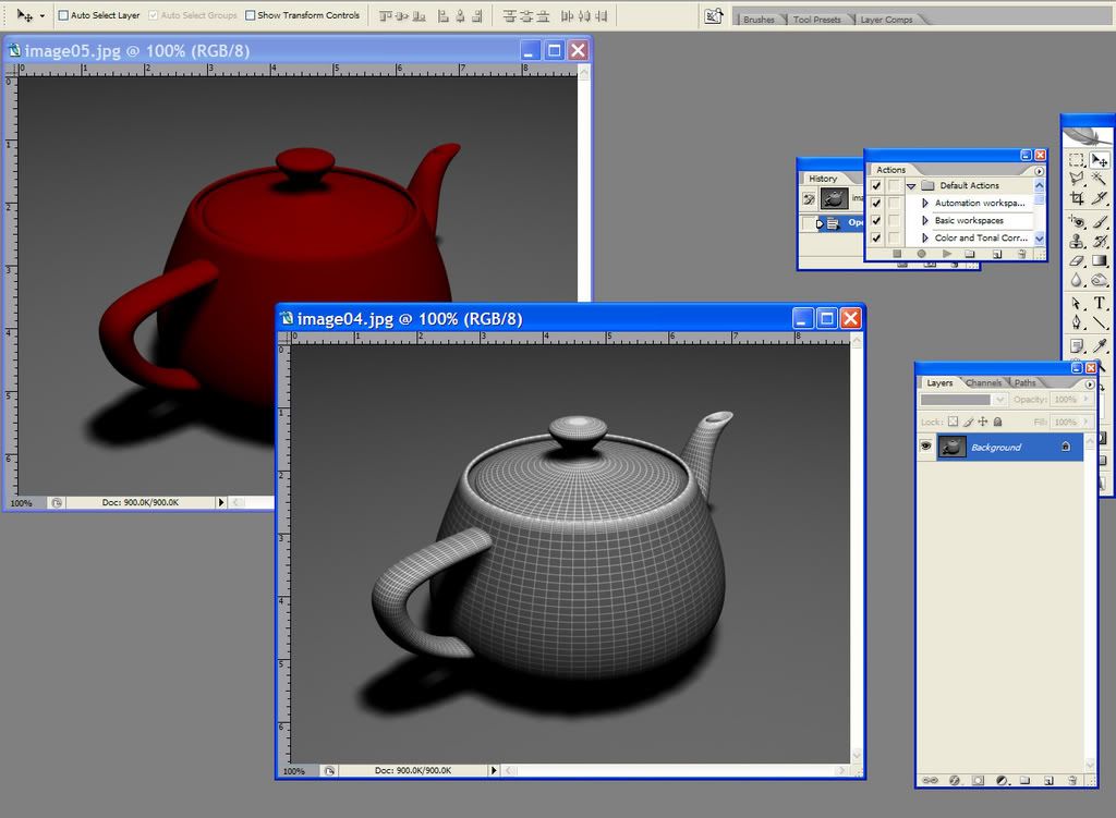

I have also rendered a red version of the teapot without edges, so that we can compose this in Photoshop
Open Photoshop, and drag the teapot with edges over the red teapot image
In the blending type choose screen
Now you can add a layer mask for the Layer 1
and if you apply a Gradient Fill, you will obtain this
